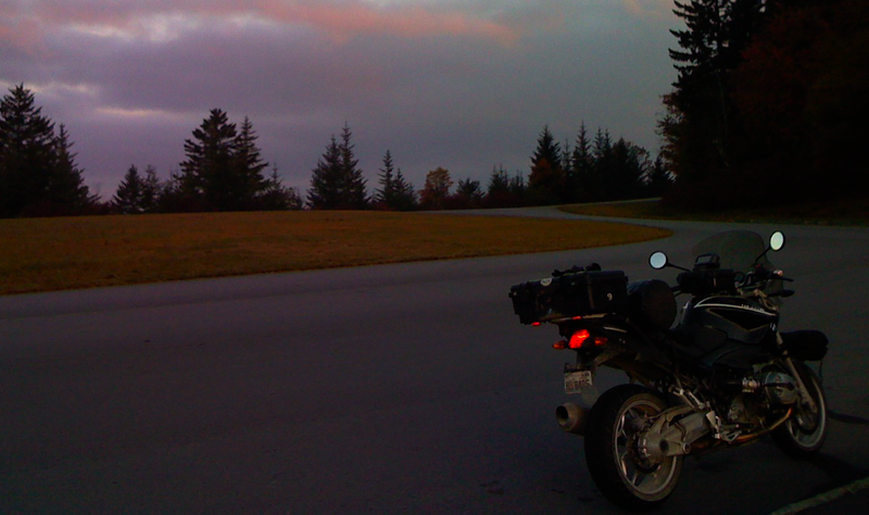

At last, here is an update on how I have managed to sort out this arrangement of luggage =D>
I have gone for the Givi V46 topcase which is attached to my bike using the Givi arms & mounting plate.
It makes the bike look a bit wider from behind, which can be a good thing, and handling doesn't seem to be much different (yet to try out on motorways/faster A roads! 8) Many thanks to Right Hand Drive (Rich) for his help - saved me lots of money :D :D and my other half who spent an afternoon in our garage with a screwdriver & my bike keys as I opted to watch football in the rain :oops: :lol:
We even have a picture to show you....first drops of rain on my shiny new bike!
