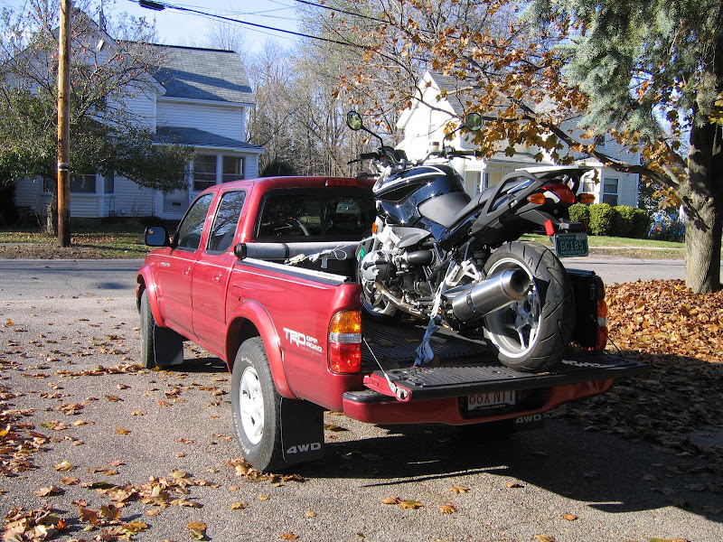

Twice a year I do this:
Once when I put it in storage, once when I take it out. Hard to tell in this photo, but it's about 25 degrees out. That's when I've had enough and I put the ol' girl to bed.
For anchoring points I used the trellis by the rear foot pegs and the and the big cast aluminum thingy on the telelever suspension....sorry....vocabulary gone. Too. Much. Tequila.

BigEasy wrote:However, unlike our friend above with his rear tire on the tail gate, I'd have to say think twice about that [-X Most modern trucks use a plastic coated steel cable on each sided to support it and one would think no worries, you could lift a tank with that. Case in point Chevy did a recall on a ton of trucks including my 2000 for cable failure.
I say buy what you like for features and money and be pretty confident that the quality/payload will be there.
Second the worry about the cables; I never did like riding with my rear wheel on the tailgate. In fact, my first truck was a '98 Dakota long-bed that I didn't have to do that with.
There are a couple of ways to avoid doing that, few of them not involving mods to the bed of the truck. A bad one is to put the bike catty-corner in the bed. Fortunately *knock on chrome* I've not had to put my bike in my new truck (2004 Dakota club cab, and dang it they stopped making the long-bed version!).
Personally, going forward I'm leaning towards something like a relatively simple, kit-built trailer. Having both gone with bikes in the bed of the truck, and trailered, I find the latter to be generally less stressful. In particular, you don't have to worry about loading the bike up a three- or four-foot steep slope, and you don't have to worry about the front wheel slipping sideways after you tie the front down. (They can "hunt" on the truck bed ribs.) There are no problems with hard bed covers having to be removed before installing the bike. And, as above, there are no concerns re tailgate support.

It's not the extended cab you want, it's the long bed. If anything, the extended cab - on the same truck frame - results in a shorter bed.
On the other hand, you have to ask yourself how often your bike rides in the back of your pickup, versus how often you carry groceries, luggage, pets, etc. On balance, while I will bitch and moan and complain about the lack of a long-bed, the simple truth is the extended-cab, short-bed is more useful to me 99%+ of the time.
As was pointed out above, small utility trailers - that you own or that you rent - are excellent options ... and for short distances, having the rear wheel on the tailgate isn't a disaster. After all ... the whole weight of the bike rides up and over it anyway, right?
