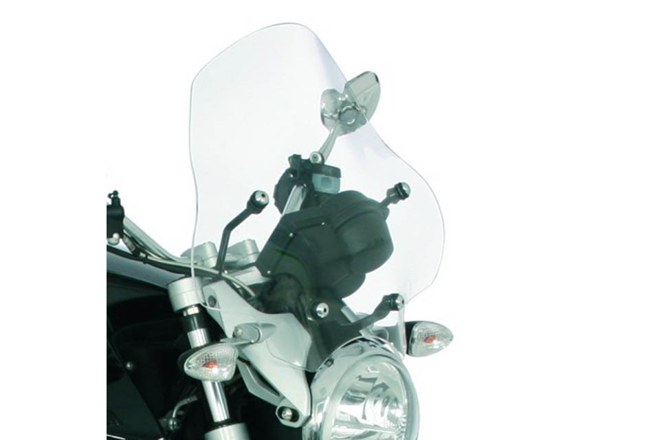

My Givi windshield looks a lot like that one. It is OK like for trips to Daytona in the winter but I don't like the looks of a big lexan sail and almost everyone complains of noise and turbulence. And I get them with this windshield. I just use it to keep as much of the cold air of off me as possible during the coldest months.
I'd trade it to someone for a BMW touring shield and mounting bracket.
