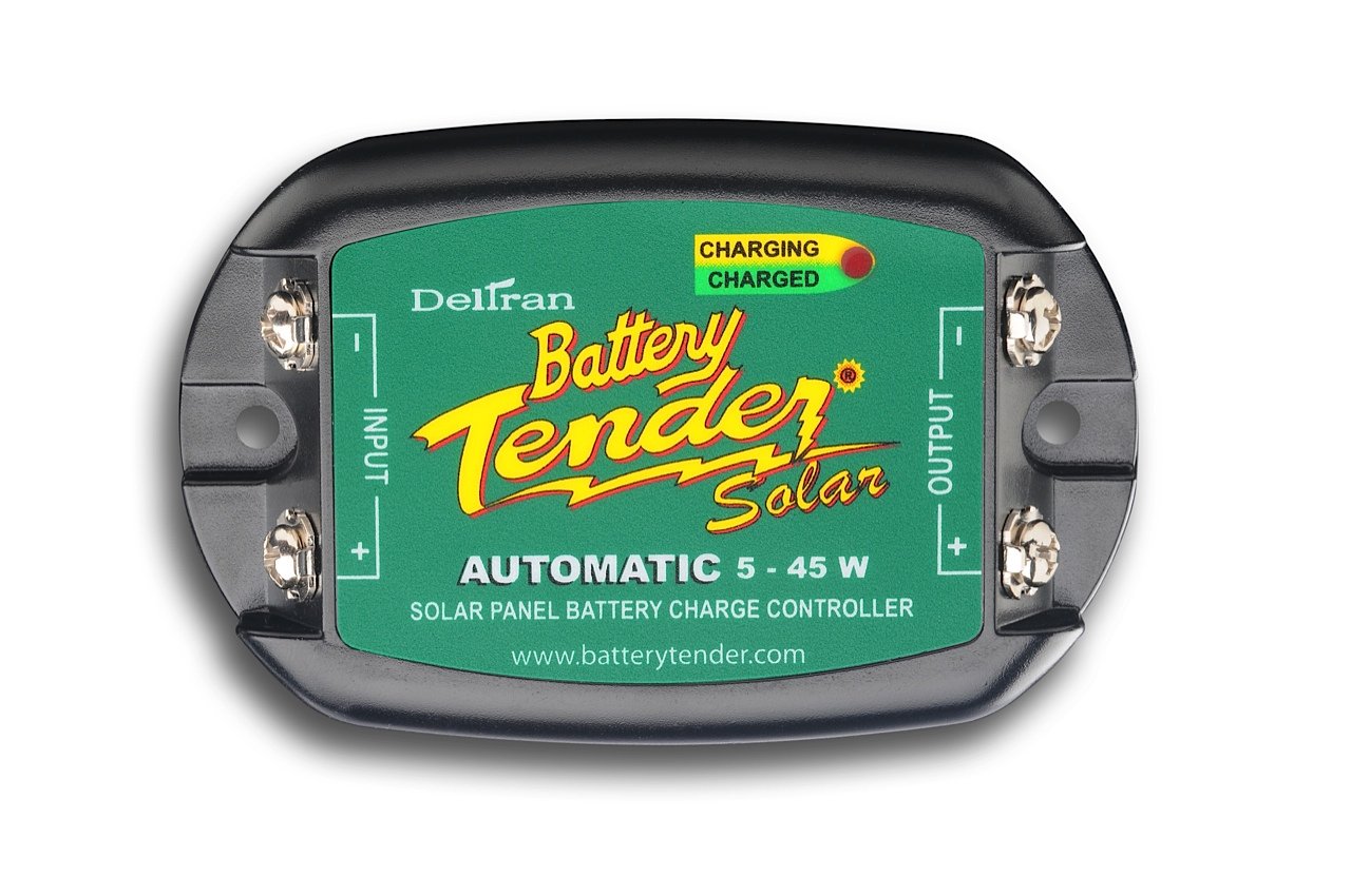

CycleRob
Posts: 2857
Joined: Mon Mar 21, 2005 12:29 am
Location: Enjoying retirement in Gainesville GA. USA
Re: Battery Drain/Solar Charger
Post by CycleRob »
Bogdan,
If you are going solar, you'll need to make the money invested spent wisely . . . that is do NOT skimp on the price for small panels that have less than 10 Watts (.83 Amps) of power. Besides the low power, their mediocre quality means they become dull from sun fade, and die from broken inter cell connectors in two years or less.
I checked the net and came up with theses 2 options (totalling $64) that would work well together, behave as almost the functional equivalent of a 120V AC charger in that they would be able to make up for time lost if sunlight is not available for 5 days of rain -and- last a long time. You'll need to add the 14 AWG wiring needed, keeping the total lengths as short as possible. Mounting and aiming the panel requires some expertise, so mounting security and full power is utilized. BTW, the bad 1 star customer reviews added on the charge controller are from those mixed in from the 5, 10 and 15 Watt Tender solarpanel/controller combos on the same page that had poor ratings because of the connections and solar cell panel's quality.
Solar Panel Dimensions: 20 x 14 x 1 inch; 5.3 pounds ($46):
http://www.amazon.com/Infinium-Solar-Pa ... oduct_sims
Charge controller ($18):
http://www.amazon.com/Battery-Tender-02 ... ref=sr_1_4
