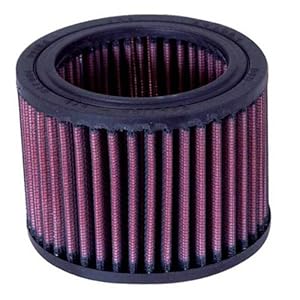

Oilhead
Posts: 353
Joined: Thu Mar 24, 2005 9:42 am
Location: Connecticut
Re: Air filter access
Post by Oilhead »
Sunbeemer wrote:Flatter, as in not as tall?
If so, how does it make the seal to the top of the airbox (underside of the cover) to keep dirt out of the engine?
Yes the height is the same, it is the overall diameter that is significantly larger on the OEM filter. Here are pics for comparison.

Sunbeemer
Posts: 1491
Joined: Tue Jul 12, 2005 8:48 pm
Donating Member #: 593
Post by Sunbeemer »
Ah! I see. Thanks Oilhead.
If I were a K&N fan, that would simplify changing it!
However I believe they don't filter out fine particulates as well as paper, especially after the oil dries out of them which happens in about three weeks here in summer, but they do breathe better!
So I guess it comes down to a question of performance vs. longevity, and I'm keeping mine!
