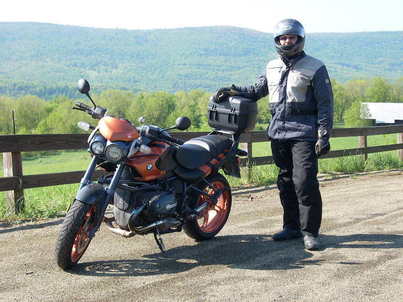

This is probably the best pic of what I did with an $8 tip from RS Strauss
DJdownunder did something cool with his R, he put an inverted "tang" on the inside of the existing bracket, so either bag could be used. Search around for his posts and you'll find it.
