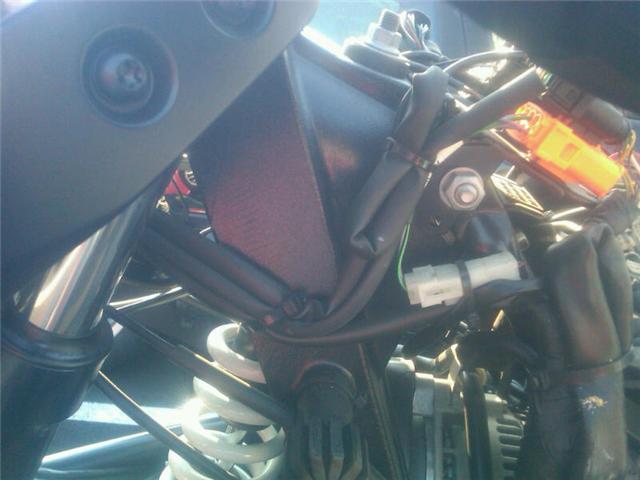

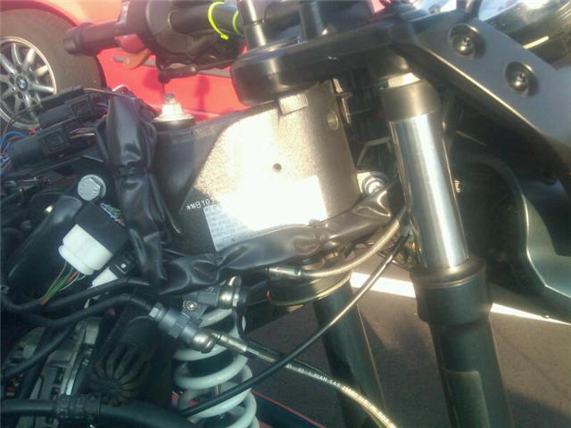

OK before I go skinning wires 'willy-nilly', I wanted to find out from you guys which is the more problematic side the left hand side harness or the right hand side harness.... the pictures will say it better.... as you can see I took off the tank =D> - thanks Sweatmark for the Youtube clip :D , now I need to know which wires to mess with..... This....
OR
Right hand harness
Oh and the background to all this, for those who haven't read the entire thread and have no inclination to so do, my bike cut off in traffic and has not fired up since, I'm installing new Jiffy-tite QC's and a new Odyssey PC 680 battery but also wanted to address the wire-harness issue.
Thanks.

Hi,
I checked both sides. Only the outer sheath appeared split on the right side (assuming you are on the bike)
I found the breaks on the left nearest the bottom of the steering head.
Hope this helps,
Rob.
