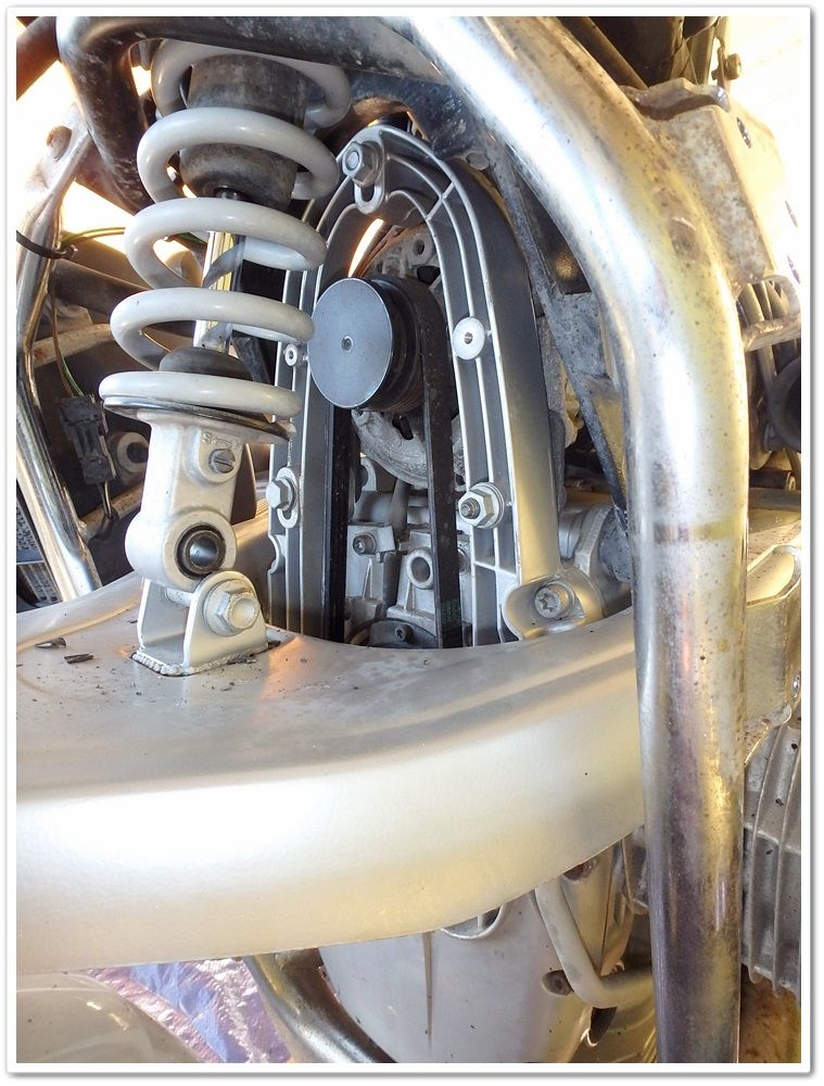

I removed the belt cover to check out the condition of the belt and to turn the engine over with a spanner... I had to remove the lower shock bolt as the cover would not slip past the spring.
