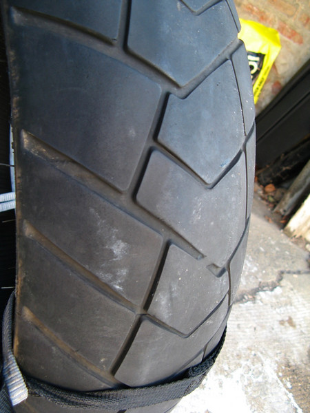

Since I finally changed out my rear Scorpion Sync, I figure I'd let you know the actual milage.
4700 miles is what the rear lasted me. I could have squeezed another 500 out of them, but at the time I was heading into a big storm and was looking at riding in rain and/or snow for days so I didn't take the chance.
I was glad I did because I rode through the snow storm in Atlanta. With the fresh Pirelli on I made it through just fine.
These tires are awesome.
